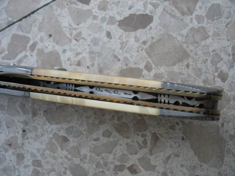

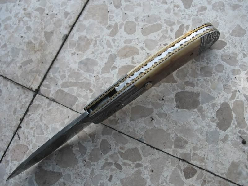

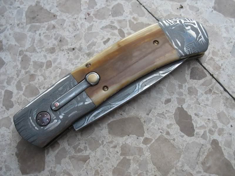

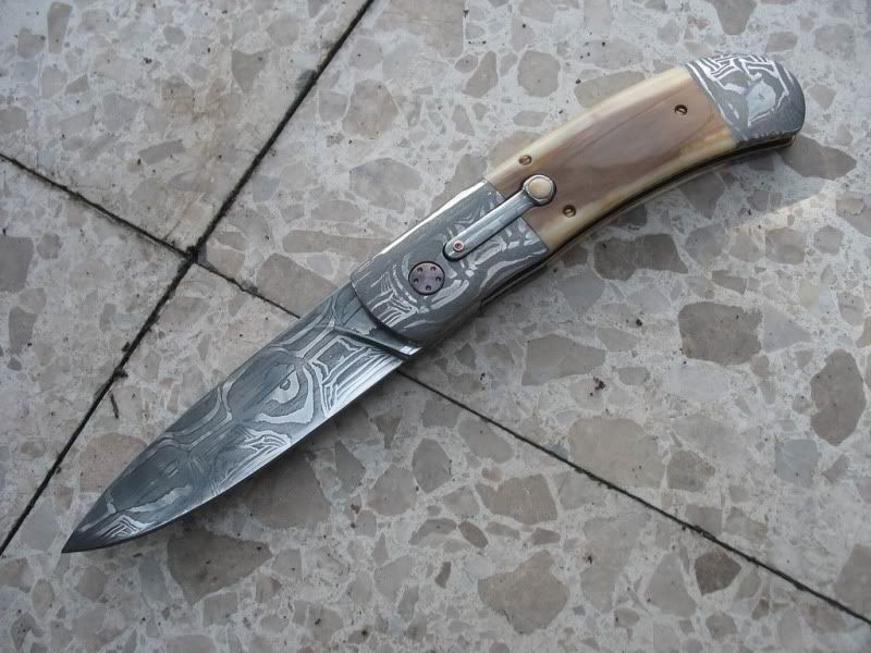

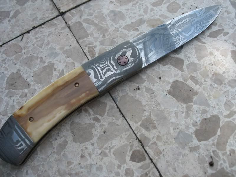

Re: papi knives
Messagepar kurios » 06 Avr 2010 19:47
Belle réalisation mais un peu chargé quand même... L'espèce de languette c'est un clip ou ça fait partie du mécanisme?
Messages: 13219
Re: papi knives
Messagepar Blastmaster1972 » 07 Avr 2010 03:17
kurios a écrit: L'espèce de languette c'est un clip ou ça fait partie du mécanisme?
Partie du mechanisme. C'est une automatique.

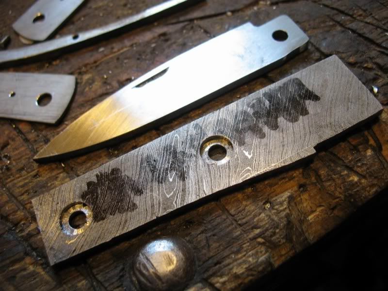

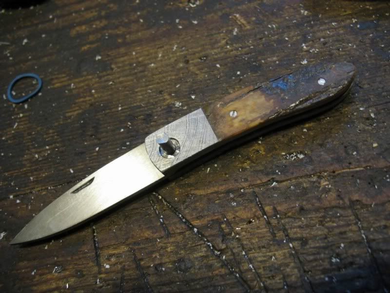

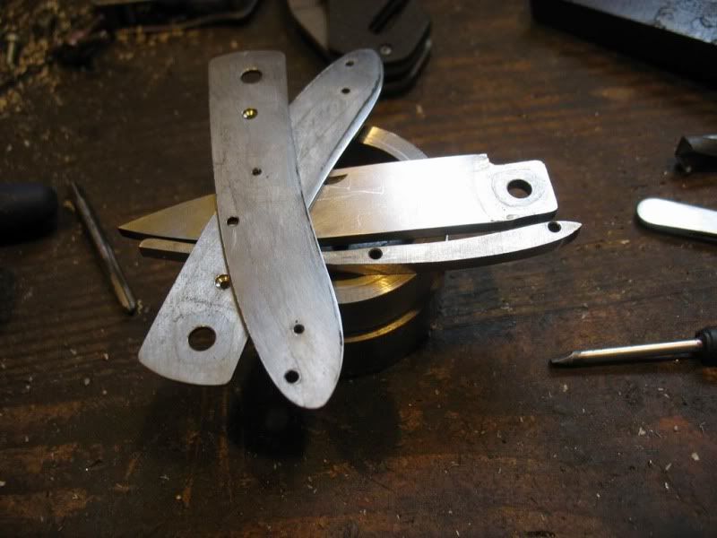

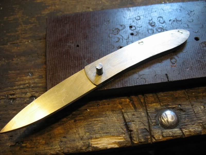

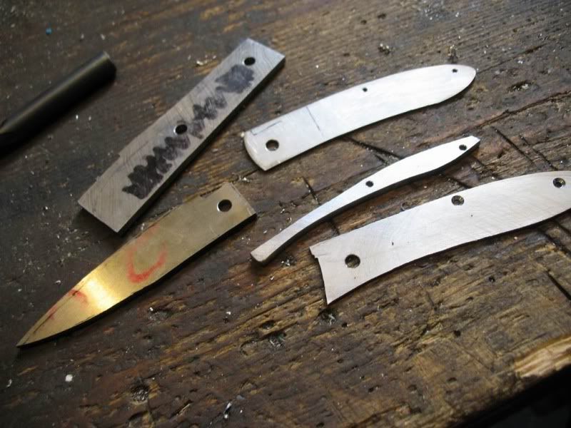

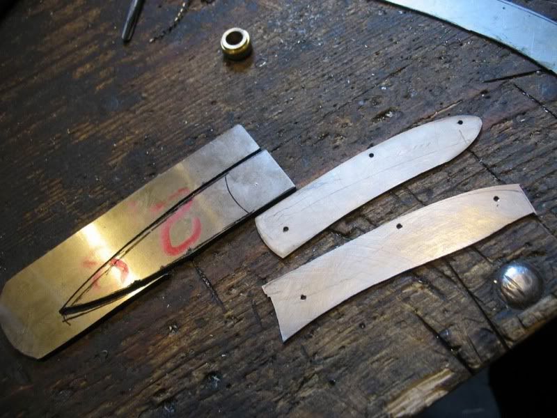

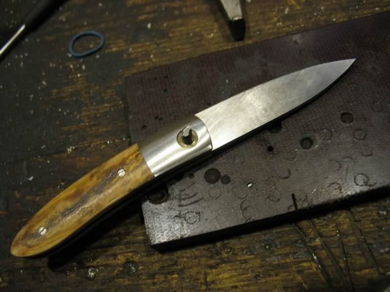

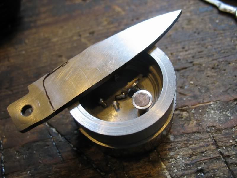

J'ai commande un "slipjoint" chez Ondrej. Ici quelques photos "WIP" (work in progress). Lame Wootz, mitres damascus et manche ivoire mammouth.
papi a écrit:Hey everyone,
got a big update today, i've been working almost exclusively on one knife, cause my buddy from the machine shop finally brought me the wootz steel i had him EDM cut in half (too thick to waste the half of it), and surface ground. He woke me up with it at around 6 am, and i've been at it until now, excluding the lunch break and a trip to post office. I figured it's time Jos finally got his knife, right ?:)
Now, i have cut the blade out of one of the pieces of wootz...LOVE my bandsaw - i had almost no clean up grinding after the cutting
All the parts cut out and in different stages of shaping and all

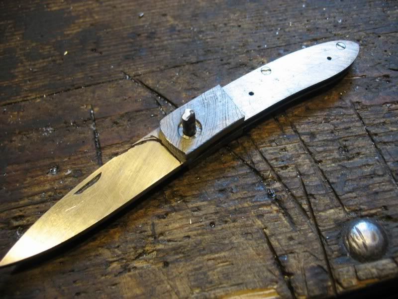

And shaped together
Milling done - it goes really fast when you're not cutting locks, milling under them...i love slippies, they are really pleasure to make :)
Bolsters in place and shaped

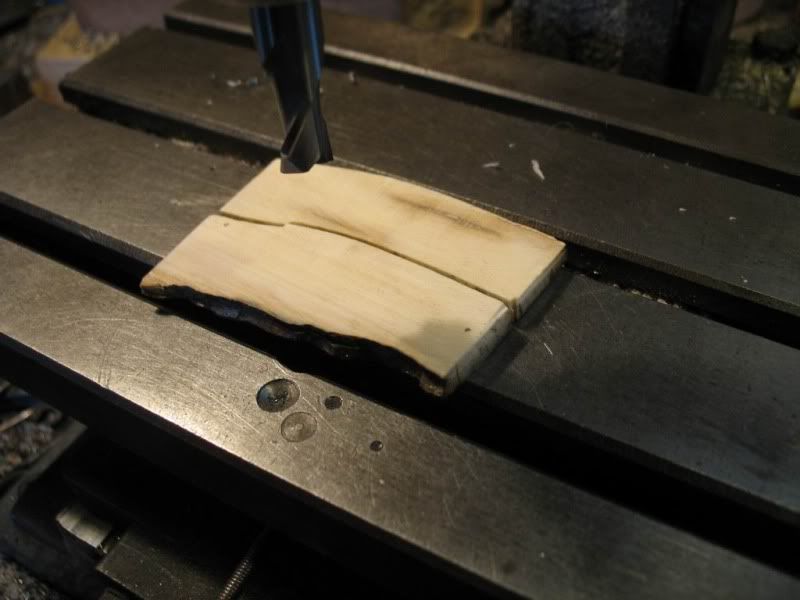

I thought i would stop at this point, cause i had done enough for the day, but frankly, i didn't have anything better to do :) So i cut out the scales, milled them to a correct thickness.….

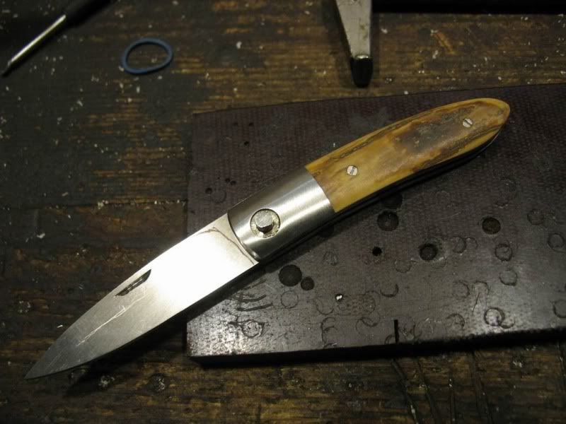

...installed them on the knife.…
...and contoured the handle, finishing at 240 grit all around...
At this point, i'm beat :) But i will pick it up tomorrow, i want to grind and HT the blade and finish the handle... we'll see about that :)
Thanks for looking, Ondrej

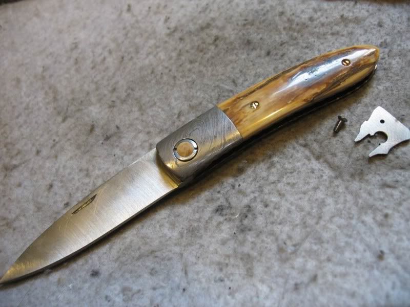

Messagepar Blastmaster1972 » 20 Avr 2010 18:44

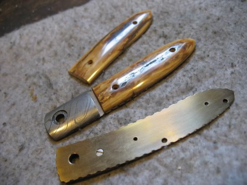

Suite. C'est presque fini! :spc:
papi a écrit:Another update, i have been at this one all day again, and after today, all i have left to do is finish the blade, and put the whole knife back together :)
Here are the parts that need to be 'dealt' with :)
Liners fileworked, everything etched and polished...
Now just the blade and the screws
And the blade just before heat treating, the whole handle is finished now :)
Finished pics tomorrow :)

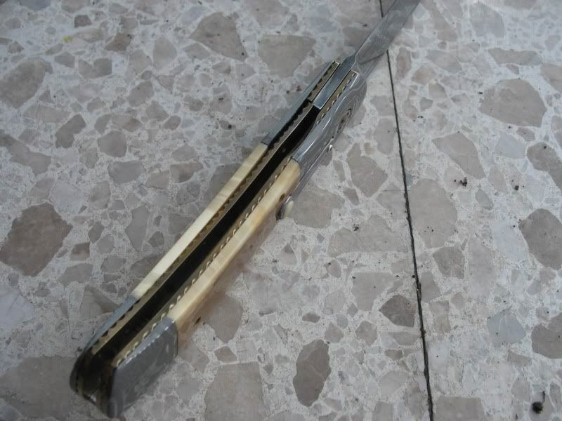

Maintenant le pliant est fini. Je suis tres content! :spc:
i finished this baby yesterday, it has wootz blade, twist damascus bolsters, and mammoth ivory scales. The liners are fileworked and anodized titanium, screws are heat colored gold, and the pivot screws have mammoth ivory inlays in them.
Let me know what you think, take care,
Ondrej

Joli, et très classe, un beau gentlemen folder.

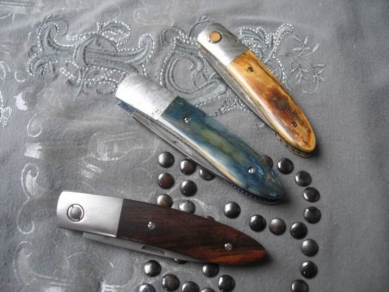

Messagepar Blastmaster1972 » 15 Aoû 2010 15:56

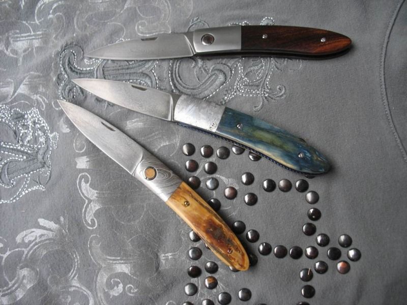

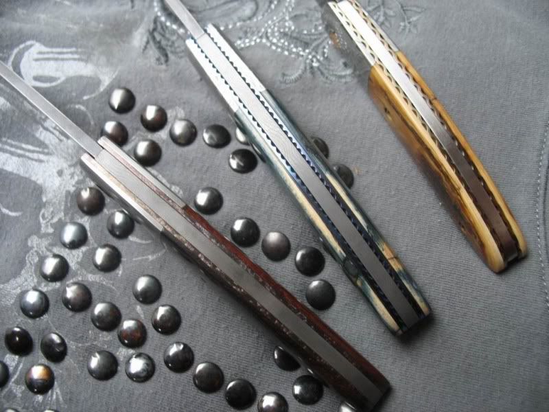

Il va venir a Gembloux! :spc:
Mes 3 "Papi" :
