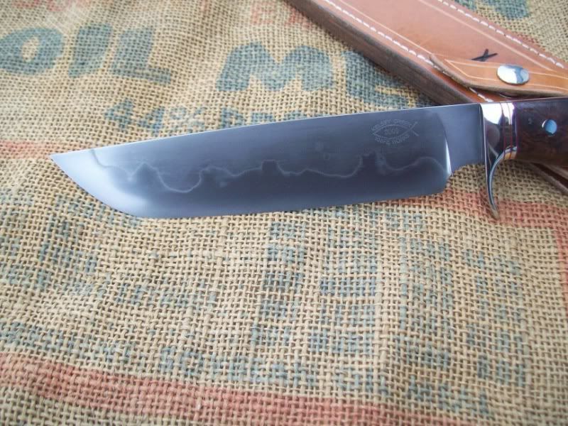

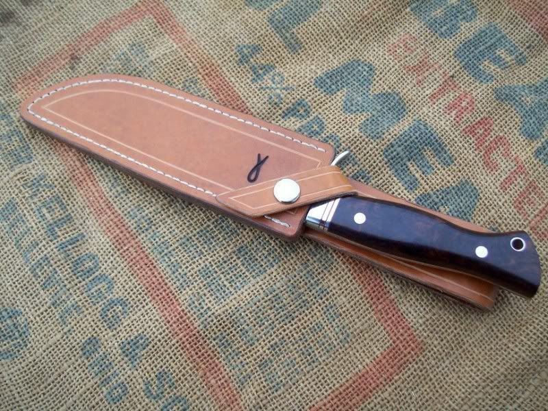

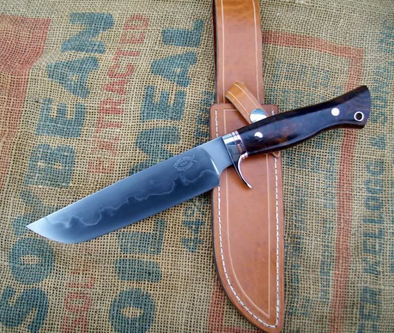

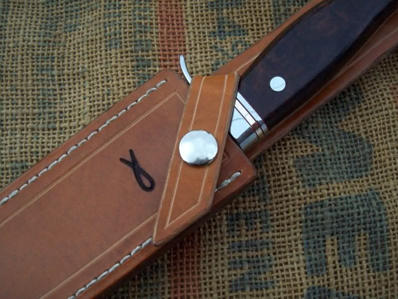

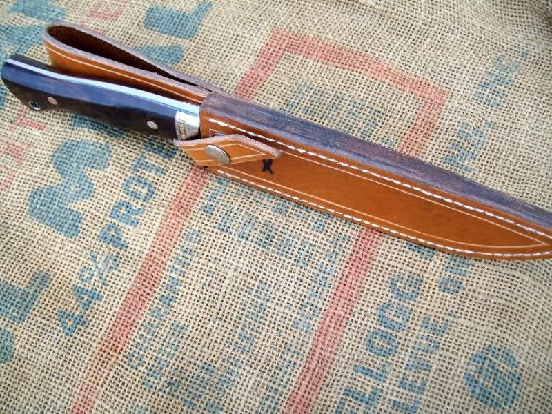

I wanted to post a few descent pics of the Camp Knife I made for the 2009 Build-Off.
I also made a sheath and gave the hamon the TLC it needed :) ;)
This is a 1095 Camp Style Knife. I make them to use.
I forged the blade from 1095. Heat Treat was 4 normalizing cycles after forging, clay coated & austenitized at 1480*F w/~15 minute soak, quenched in Parks #50. Tempered @ 425* F 1-1/2 hrs x 2, it came in @ ~ 60-61 HRC. It has a full tapered tang, soldered & pinned 416 stainless guard, 655 silicon bronze spacer & a few .010 red spacers in between. Handle scales are Ironwood backed with .010 red liner. Handle pins & lanyard tube are also stainless.
It has convex grind to nearly a zero edge. Sharp yet tough !
Sheath is hand sewn 9-10 oz. veg tanned leather from Weaver.
OAL 12-3/8"
Blade Length 7-7/16"
I hope you guys like the pics. Thanks for checking them out :bow:

Messagepar lichtenfeld » 04 Avr 2009 02:03
bof.
c'est aseptisé, pas de personnalité véritable
