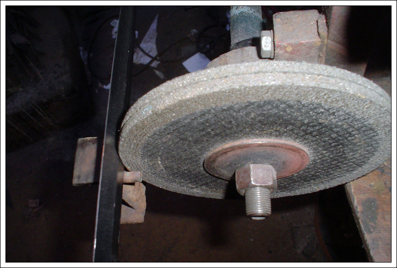

Two 7" diameter x 1/4" thickness grinding discs from an angular/hand grinder.
I place them together on a bench grinder, and with the aid of the supporting piece, I can work safely using leather gloves to keep the blade pressed enough to get a fast rough grinding.

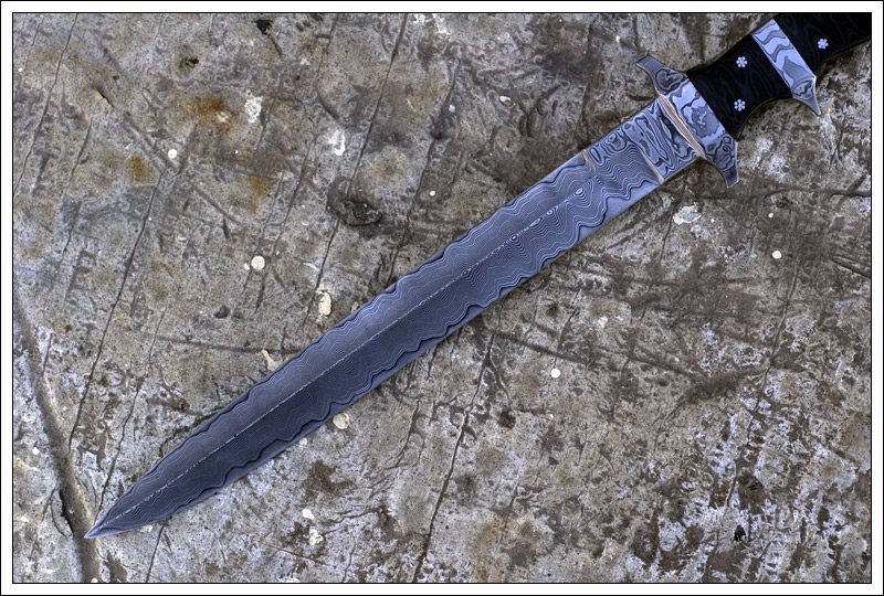

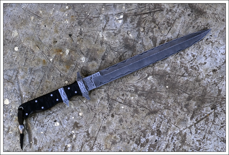

So I finished it and got decent pictures.
Integral San Mai Sub Hilt Fighter
San mai damascus 1010/1070 with a 5160 core.
16 1/4" overall length, 10" blade. 1/4" thickness. Double edged.
Hand made black and grey micarta handle. Cable pins. Leather lanyard with a 1010/1070 "droplet" style bead. Heavy duty handmade leather sheath.
Sheath still need to be finished, but it's 90% done. Yes, I do hand stitch my sheaths.
In hand.
